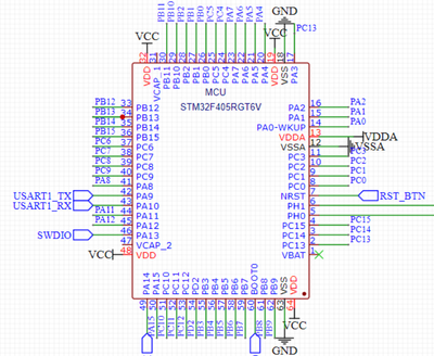

I  have a STM32F405 and am trying to setup UART to connect to my pc. As of now I have connected it with an ST-Link/V2 and later on want to program it over USB-C using UART. See the wiring diagram:
I have used PA10 and PA9 for RX and TX.

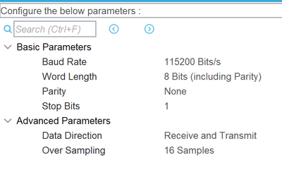

The parameter settings are as followed:

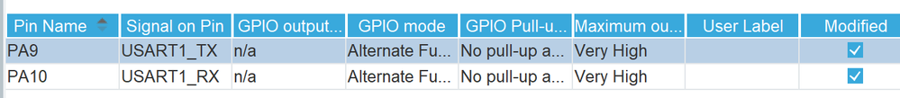

When it comes to the GPIO settings I have set the maximum output speed to "Very High" (not sure if this is correct).

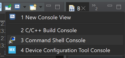

I have watched a guide on YouTube (https://youtu.be/dnfuNT1dPiM?t=4896) about how to getstarted in the STM32CubeIDE and stopped on the part about the "Command Shell Console":

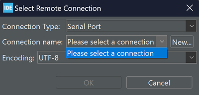

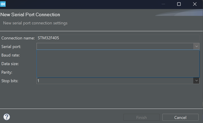

At "Connection name" I had none and preesed "New..."
Now on the "Serial port", I dont know what to do. See image:
I am using a Windows 11 computer and heard something about using Tera Term or Putty, but I dont know how.
Can someone explain some more about the Serial port setting?

" I have set the maximum output speed to "Very High""
Not optimum but it works. I suggest Low to set them to low instead of very high.

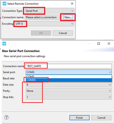

Now regarding the config of the Hyperterminal:
You need to check what is the Comport number assigned by windows on your computer. You need to go to Device manager on your computer and go to Ports (COM & LPT) list:
This is what I found as comport number : COM26. You can find another number. This is what you need to put in Serial port in the CubeIDE console:
Hope I answered your question.

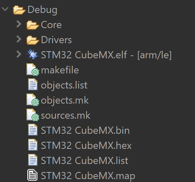

I have tried using the .bin file which is located in the "Debug" folder when I generated my code.

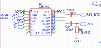

I can try to explain my setup somewhat better. The STM32F4 is power not powered by the USB-C, it uses another source on the PCB. The pins PA9(TX) and PA10(RX) go to the serial chip (CH340C). See wiring diagram:
From the serial chip (CH340C) pin D+ and D- are connected to the USB-C port. See wiring diagram:
RX/TX are correct from the STM32, such that RX goes to TX on the serial chip and TX goes to RX.
Hope this helps understand the problem.

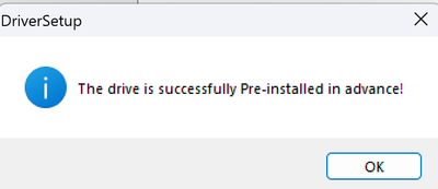

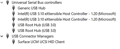

I have now installed the driver for the the CH340C and should be working.
I however do not see the Com port in the Device Manager.
Do I need to enable UART somewhere in the STM32IDE program?
