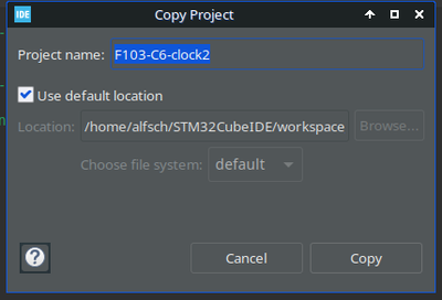

"My"  way to make a copy/clone is little more easy , i think:
1. in IDE , left, "project explorer" , mark the project and right click mouse : -> copy
2. right click (in free area) here: -> paste
3. it (adds a number, "2" here, and )  asks:
-> Copy .

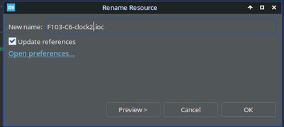

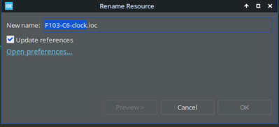

4. so correct the names, right click on : xx.ioc, -> rename : it asks..
(we want it to update names inside xx.ioc , so ...add "2" :
-> ok.

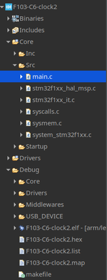

5: then we delete the old-named outputs:

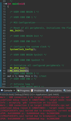

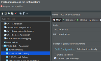

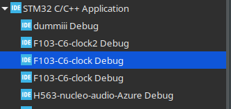

- but still debug wrong, so open menu -> debug configurations :
right click on the wrong copy : new configuration , then we get: xxx2.debug

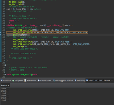

6. open the main.c , compile ...the hammer. :)
we get:  output with new names:

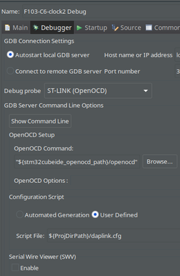

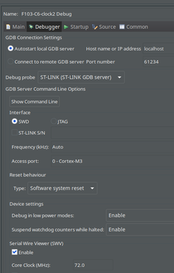

7: but still debug is wrong :
...so : click : browse, to give him its elf file:
- and adjust the debug settings, as you like them:
with OCD and a cmsis daplink: just for fun...
...or with st-link :
8. try...debug now:
... and here we are, with a working clone/copy .

And with st-link also SWV working:
