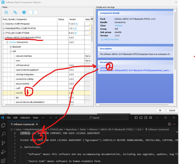

I'm using 1.15.1 CubeIDE and the package is mine. I'm creating a cmsis-pack for the arm IDEs including stm32cubeIDE.
I reckon that cubeIDE doesn't support this cmsis-pack feature. because I can see that even the packages that are shipped with cubeIDE such as Infineon AIROC they show Infineon license for all the sub components:
