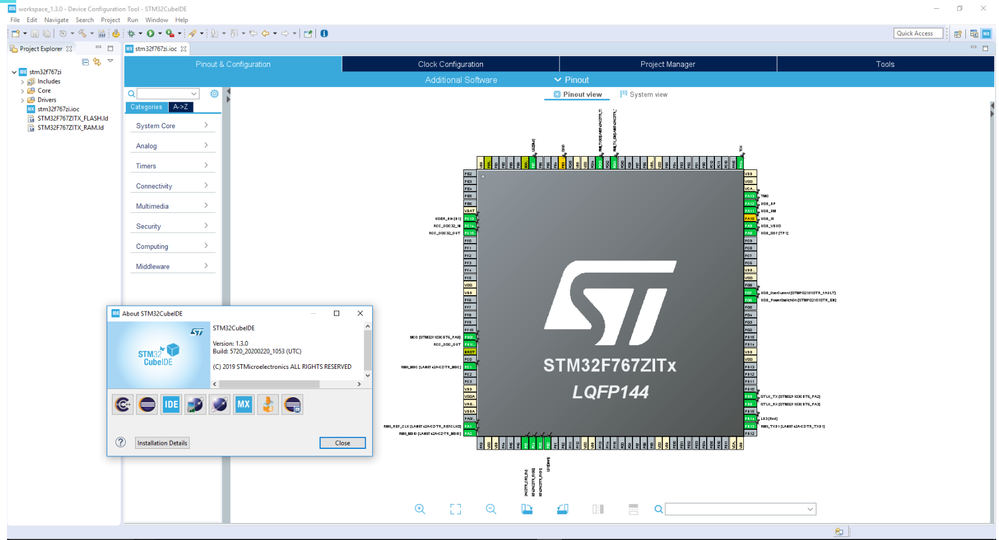

If i build a new ST3M2 project and i check yes for peripherals initialization with default mode it doesn't work. All the pins are bound to reset_state. I tryed to update and to uninstall the software but if i click yes on initialize the pins i get the same result as if i had clicked no.
Any clue how to fix this?I am sorry but i am a new user.

Hello @GMila.1​
Could you please tell me which version of STM32CubeIDE do you use.
Best regards,
Nesrine
‎2020-04-24 1:28 AM
Hi.
This bug presented to me using 1.3.0 either 1.3.1 version of CUBEIDE. I Installed now 1.2.0 version and the problem doesn't appear with the old version.

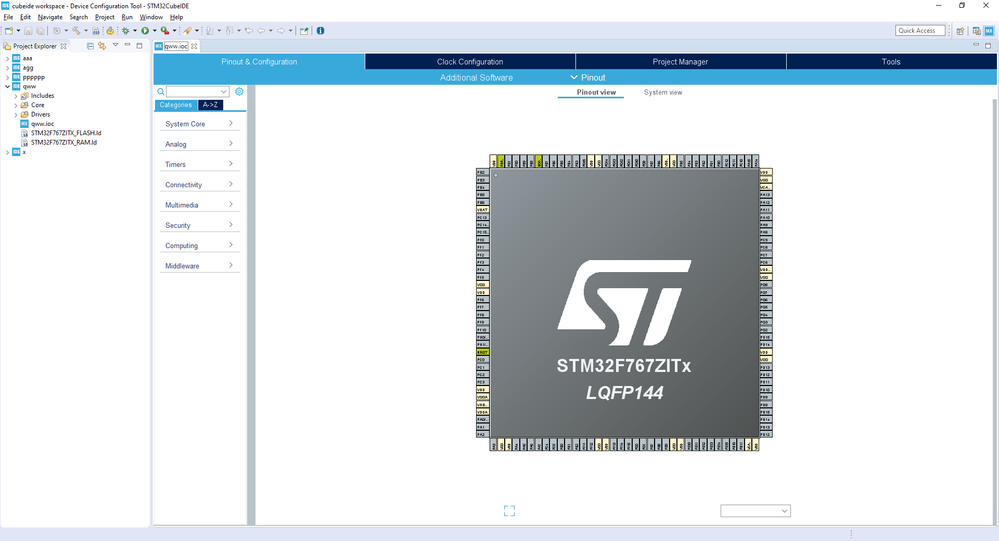

‎2020-09-18 11:22 AM
I have a similar issue but the initialization of peripherals to default dialog not appearing for me. So I cant set the pins and they are all grayed out. Can you help me out?
‎2020-11-19 12:12 AM
I have the same problem with 1.3.0, 1.4.0 and 1.5.0 working under WIN10. Has anyone solved the problem?

‎2020-11-19 12:49 AM
‎2020-11-19 1:55 AM
@Nesrine.JLASSI it seems that I solved the problem. Simply I removed the "STM32\Repository" directory and now everything works fine.
