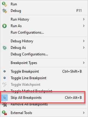

Its late but in case anyone wonders ...
Use menu "Run" and deselect option "Skip All Breakpoints"
