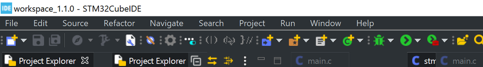

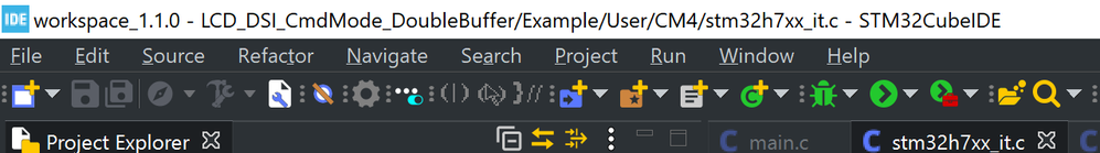

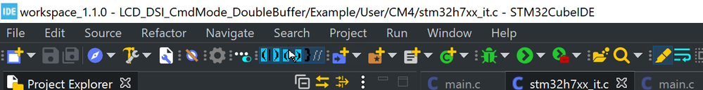

When I move my cursor over the document tabs in CueIDE the tabs go blank and sometimes disappear. Please see video.

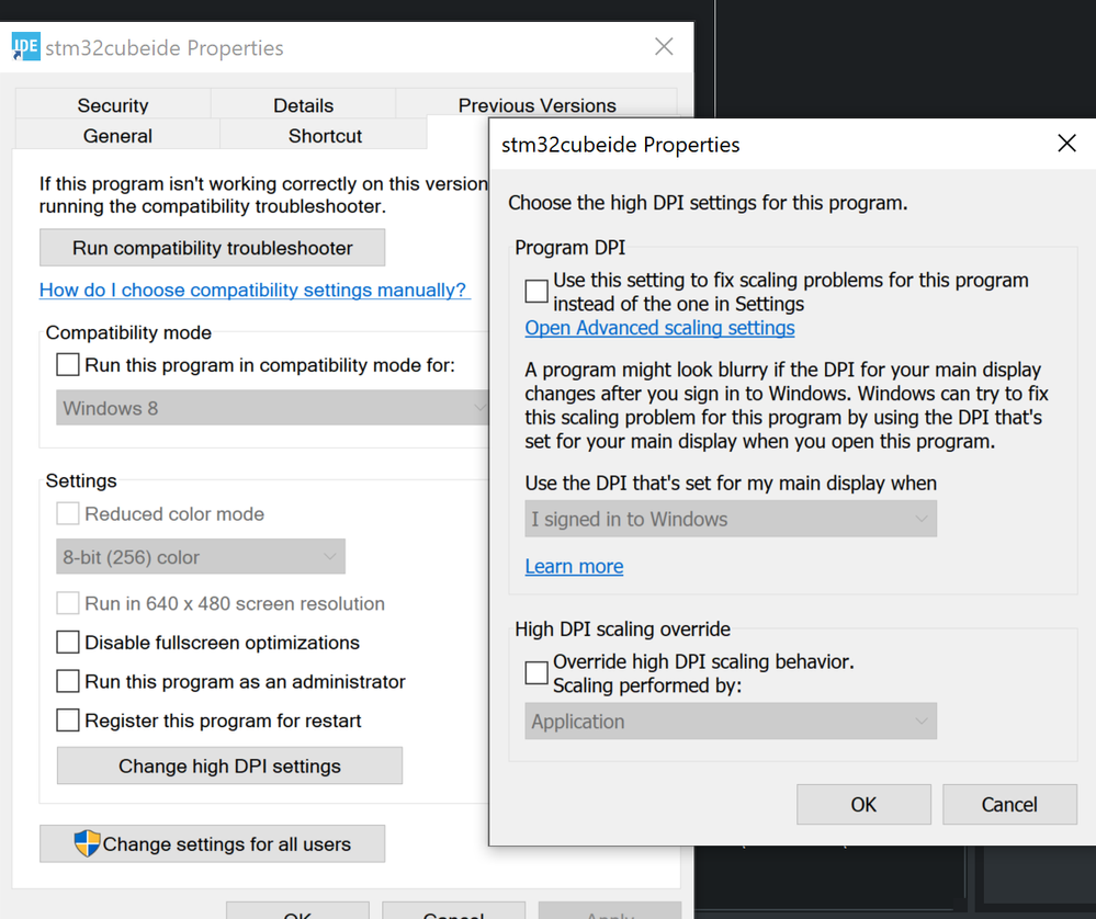

Compatibility settings to scale menu and toolbar to reasonable size -

This problem used to happen occasionally with 1.7, but it is chronic with 1.8.0. I desn't happen if you don't change the default compatibility mode settings, but the icons end up extremely small.

Disable any compatibility/DPI scaling mode and it works well. The program scales icons/text appropriately, at least for me in Win10 on a 4K monitor. v1.8.0. Older versions had issues which required compatibility mode.

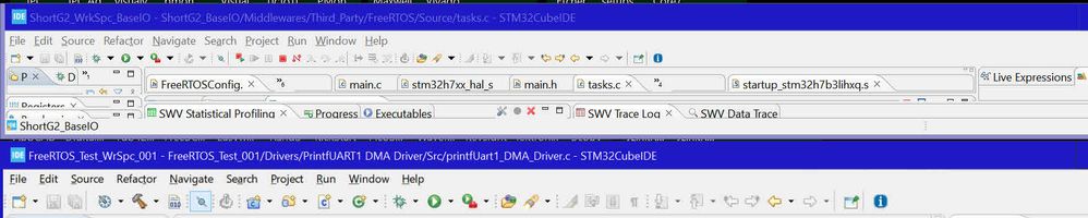

That is strange. I did a bog standard install of 1.8 then upgraded it to 1.9 - so upgrading is working for me now: However I end up with tiny icons. Here is a screen shot of the two; top one no compat, bottom 1 with compat.
What's your screen res. and what graphics card are you using?

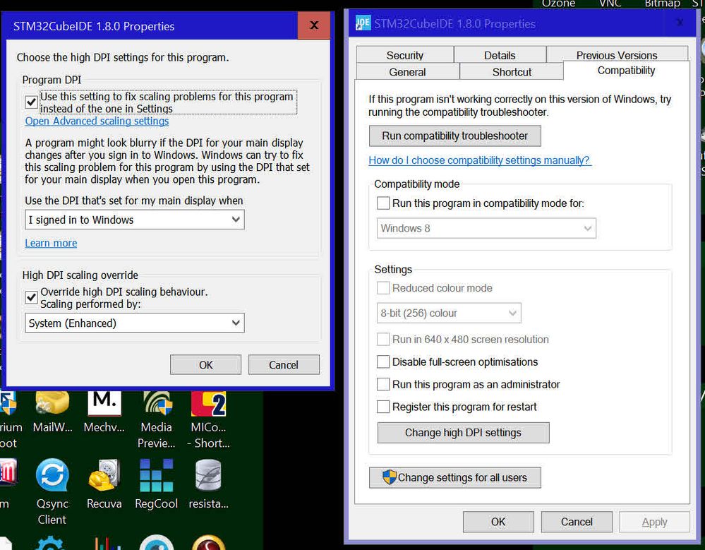

Compatibility set to "Override high DPI: Application":
Compatibility set to "Override high DPI...: System (Enhanced)": (Note the blank and duplicated file tab just like you mentioned in your OP, and more blocky icons, but correct size)
Compatibility completely off:
Looking at them all side by side, it's clear there are subtle icon/spacing/sizing differences, but very subtle and not drastic as in your screenshots.
Not sure what would be different between us. Weird.
