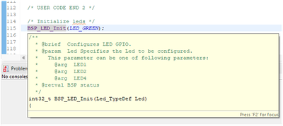

I made this function (see Figure 1) and made documenting comment. When I calling this function or I hover the cursor over the function name a tooltip with the function code pops up, but I want to see description of the function (@brief parameter from documenting comment, see Figure 1).

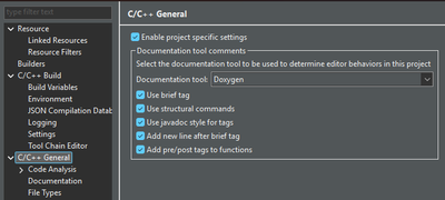

OK, I see I missed one thing you mentioned, and I'm sorry about that: the Eclipse/STM32CubeIDE has a built-in option for easier generation of documentation comments, as shown in the screenshot.

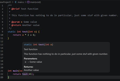

But still, it's only for creating documentation comments for external tool; I'm not able to force the STM32CubeIDE to create hover pop-ups with formatted documentation, as it's done in other IDEs. Below is a screen from VS Code.
@Artur Laskowski do you see in CubeIDE unformatted function comment like below?
This is behavior of Eclipse. CubeIDE just inherits it from the Eclipse CDT code base. It can be improved, anyone is welcome to contribute.
The source seems to be in org.eclipse.cdt.internal.ui.text.hover.CDeclarationHover; getHoverInfo():
https://github.com/eclipse-cdt/cdt/blob/main/core/org.eclipse.cdt.ui/src/org/eclipse/cdt/internal/ui/text/c/hover/CSourceHover.java ~ line 723
