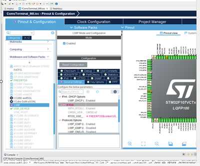

Does anyone know what is causing this error and how to fix it in STMCubeIDE?
As shown, this is specific to STM32F107VCT as it may be that STM32F4 does not see this. Buildable code cannot be generated.
Thanks!

Have you tried to change the value in red here :
to 1 on the .IOC file and then regenerate the code. That should work.

The RTOS_NEWLIB_REENTRANT (FREERTOS USE_NEWLIB_REENTRANT 1) is linked to FREERTOS API CMSIS version parameter. It should be set to 1 so a newlib reent structure will be allocated for each created task wish allow. This parameter takes 0 or 1 to eliminate the warning message. More details on the MACRO available in this link.

Hi @STTwo-32
Yes, that was the first thing I tried before opening this post. This field does not accept changes.
Is newlib already tucked into this tree? Even if I were able to change that field, which I can't, does this project still need newlib added to the build tree?
Cheers

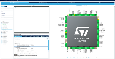

Hi @STTwo-32 ,
Correction ... it did accept a change to 1. It builds now without errors!!
I've been able to change this value on my side using CubeIDE 1.14.1 and everything works fine for me with no need to add any newlib:
Best Regards.

That works after all. The code builds without errors.
Thanks for your help!!
