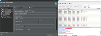

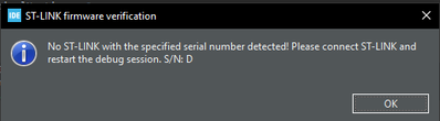

Hello everyone,
I trying debug a project,bu t when I connect Scan my ST-Link in CubeIDE got wrong S/N and error when start.
In ST-Link Utility gets rigth S/N.
Any solve for this case?
I have tried ohter cable, drivers and etc...

same problem see:
https://community.st.com/t5/stm32cubeide-mcu/stm32cubeide-not-finding-st-link/td-p/577346

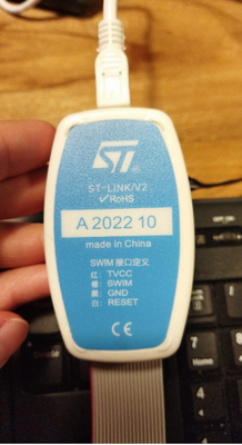

SN "D" shows, IDE found no genuine STM chip on stlink programmer, refuses to work.

Two applications can't have a connection open concurrently.
A serial number 'D' seems indicative of a clone / pirate ST-LINK.
ST-LINK Utilities has been deprecated for many years, use STM32 Cube Programmer as a better means of establishing compatibility / usability with STM32 Cube IDE

  Just wondering if you solved this issue? I am having the same problem , and work with STM32CubeProgrammer, but not CubeIDE. Thanks.
Probably the "Scan" functionality is not implemented correctly on counterfeit chips. They seem to have serial-number related issues based on the posts that pop up here.

Hello @Semer CHERNI,
Thank you for reply,
My STM32CubeIDE is version 1.13.0, I'm using a custom board with STM32L151.
When I debug get this and nothing more
Hello @Tesla DeLorean,
I openned aolne each application, the image i put together just to show.
and thank you for the tip about Programmmer.
