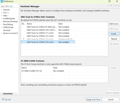

Dear all,
when I press Install button in the Toolchain Manager of the 2.0.0 CubeIDE it hangs after opening the subsequent dialog. I cannot close this dialog or press any button with neither mouse nor ESC key.
Workaround: return first back to the Toolchain Versions dialog and close it. Then I could press "Next" and continue installing GNU Tools for STM32 version.

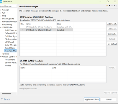

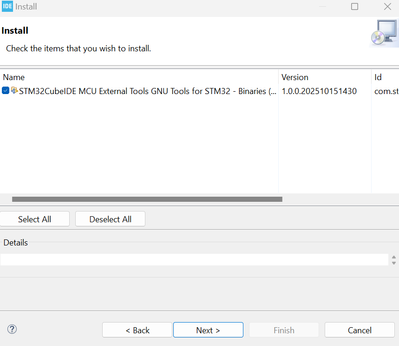

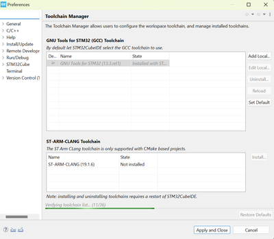

Hello @DmitryR
I performed a test using STM32CubeIDE 2.0.0 and it's working correctly as shown below
GhofraneGSOURI_0-1764685427696.pngGhofraneGSOURI_1-1764685658054.pngGhofraneGSOURI_2-1764685863015.pngGhofraneGSOURI_3-1764686288212.png
Please restart the IDE and retry again.
