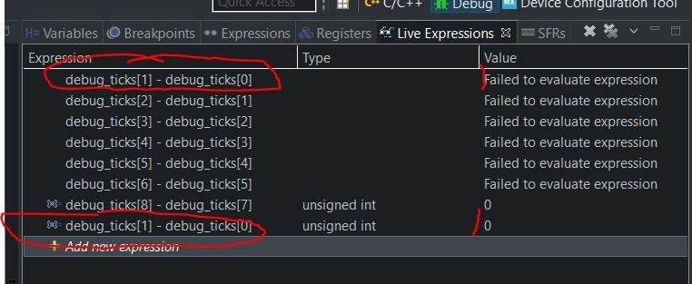

‎2020-06-04 11:24 PM
I experience the same problem - whenever I restart the debug session some of the live expressions I entered during previous debug show up as "Failed to evaluate" while some other persist being okay. Only solution is to delete the failed and re-enter same ones as new - then they work. But until next relaunch.
This is really annoying :\
This is CubeIDE v1.3.1 on Windows 10 x64
Attaching screenshot, where after relaunch some expressions failed, but when I reentered first again at the bottom it works fine.
This has been around for like a year, and still not fixed.
Can we please get some attention from ST staff so this is finally fixed? Take a look please, @Markus GIRDLAND​ , would appreciate if you forward this accordingly
