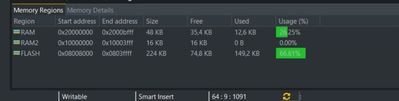

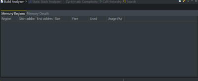

Memory regions were visible in STM32CubeIDE version 1.14.1. Later, I updated to STM32CubeIDE 1.16.1, and now the memory regions are no longer visible.
Could you please assist me with this?

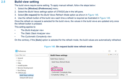

I suggest that you click on the "Refresh" button.
Please, refer to the User Manual, section 2.5 where this new button is explained and how you can change the behavior.
Thanks.
