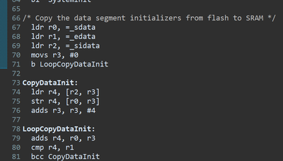

You need to both modify the linker script to store the values in flash, and you need to modify the startup code to copy those values from flash into DTCM. Here is where it happens for RAM. You'll need to add another section from DTCM, along with creating those symbols (_sdata, etc, but for DTCM) in the linker script.
Thankyou TDK,
I understand the overall priciples, the problem I had was hoew to I get the copy code to start at the Flash address of the STCM section
I experimented with a small project and found that it can be done thus:
Linker Script:
/* Memory section of Linker Script */
MEMORY
  DTCM_MISC 	 	(xrw)  	: ORIGIN = 0x20000000, LENGTH = 128K
  FLASH 			(rx)   	: ORIGIN = 0x08000000, LENGTH = 2048K ...
/* Section part of Linker Script */
  /* Initialized data sections goes into DTCM RAM, load LMA copy after code */
    /* _si_dtmc points to .DTCM_MISC segment in the flash
    	used by the startup copy loop */
  _si_dtmc = LOADADDR(.DTCM_MISC);
  .DTCM_MISC :
	. = ALIGN(4);
	_sDTCM_MISC = .;
	__sDTCM_MISC__ = _sDTCM_MISC;
	*(.DTCM_MISC) /* All nominated variables */
	. = ALIGN(4);
	_eDTCM_MISC = .;
	__eDTCM_MISC__ = _eDTCM_MISC;
  } >DTCM_MISC AT> FLASH
It is the _si_dtmc = LOADADDR(.DTCM_MISC); statement that assign the variable _si_dtmc  to that part of the flash that holds the variables allocated to the DTCM.
Startup Code:
/******** Added Start **********/
/* Start and end of miscellaneous DTCM */
.word  _sDTCM_MISC
.word  _eDTCM_MISC
.word  _si_dtmc
  /* Do next segment DTCM Initialised Data*/
  ldr r0, = _sDTCM_MISC		/*set the start addr of the DTCM */
  ldr r1, = _eDTCM_MISC		/*set the end addr of the DTCM */
  ldr r2, = _si_dtmc		/*set the start addr of the FLASH DTCM_MISC section */
  movs r3, #0
  b LoopCopyDTCMInit
CopyDTCMInit:
  ldr r4, [r2, r3]
  str r4, [r0, r3]
  adds r3, r3, #4
LoopCopyDTCMInit:
  adds r4, r0, r3
  cmp r4, r1
  bcc CopyDTCMInit
