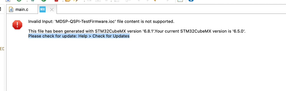

Hi, I am working on a collaborative project. Someone sent me a new version using an updated version of STM32Cube IDE, and now the .IOC throws an error when I try to open it:
To fix this, I try running Help > Check For Updates, but this gives me the following error:

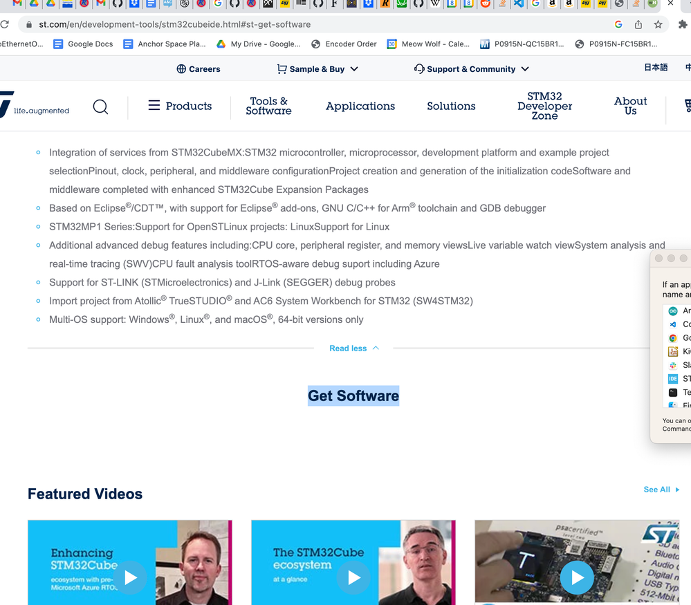

I then look on the STM32CubeIDE site, only to find the downloads section is inexplicably empty:
How do I fix this and update STM32CubeIDE? Will this solve my MX problem?

On the site, you need to log in and then wait a minute or so for the "Get Software" section to populate. It's the dumbest thing ever. That's probably your best bet.

The IOC you are trying to open has been generated with Stm32CubeMX -6.8.1, while yours is 6.5.0. Opening an IOC created with a newest CubeMX version, is not possible.
You have to install, at least, the same CubeMX version, or a more recent version.
To get that version, I recommend to download it from st.com (wait that the 'Get Software' button appears at the top of the page - It could take a minute). Then install it on your machine.
