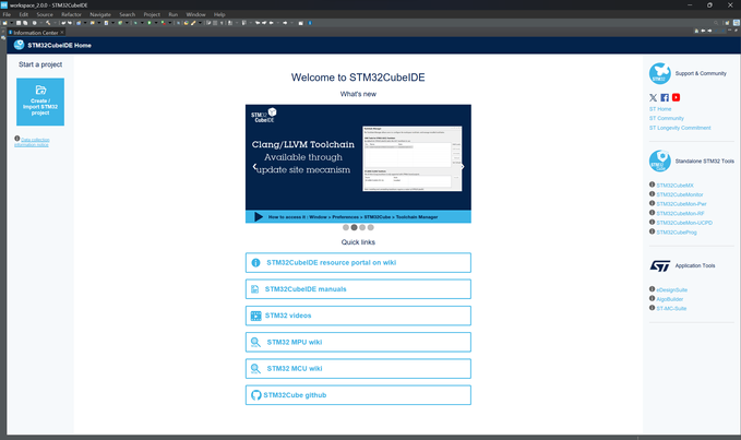

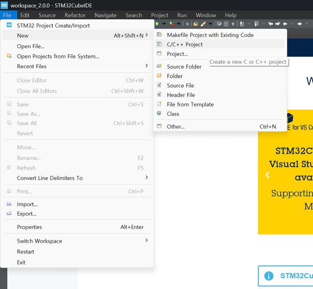

hi i re-downloaded STM32 Cube IDE but i cannot find <create STM32 Project>
I downloaded this sw over and over but nothing changed :(
please help me with this {8C3FE000-4D83-4DBB-B2F4-34F2DAD9F2D0&#125;.png{E875E59D-CCF6-4A68-ACC8-6CAD06BF6422&#125;.png

Hello @tomatohater
In the latest release , STM32CubeMX is no more integrated in STM32CubeIDE 2.0.0
For more details , please check this STM32CubeIDE 2.0.0 released
 To download CubeMX standalone please use this LINK
See: STM32CubeIDE 2.0.0 New workflow tutorial
For explanation & discussion, see: IDE Version 2.0.0 - why remove MX ?
