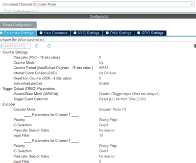

Hi, I'm using an STM32F439ZI (on a nucleo board) and connected a Zaber stage with its encoder to it. When disconnected, I can measure the A & B signals schanging from GND to 5V. I currently cannot paste an image from the scope but I've lookerd at them before and the quadrature output looks as expected with no pullups or pull downs required. I hooked the signals up to pins PE9 & PE11 and set TIM1 up to Encoder mode:
and the TIM1_init() looks like this:

yet, TIM1->CNT remains 0 as trhe encoder rotates.
Can someone here help me find where my problem might be at?
debug
This has been resolved, I was just missing to start time timer:
HAL_TIM_Encoder_Start(&htim1, TIM_CHANNEL_ALL);
