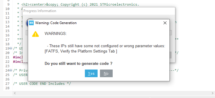

I adjusted the RCC clock and selected SDIO 4 bit wide bus bit and FATFS (SD Card ) and when i generate the code I get this warning message

Can anyone help me to fix this warning ?

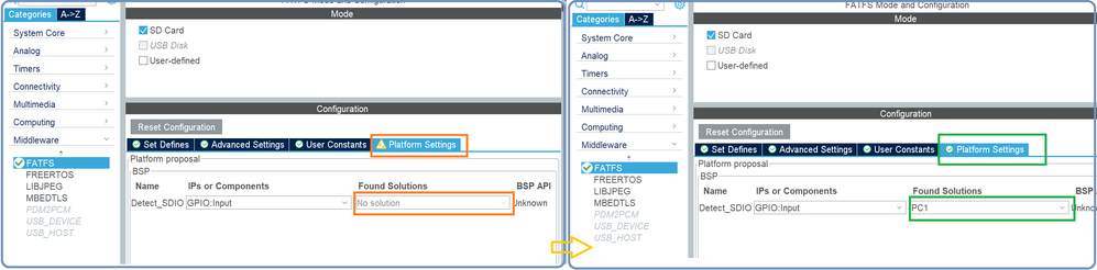

In fact, you need to select a GPIO input then add it into FATFS configuration/ Platform Settings to avoid this warning (as mentioned in the image below), then the warning message will disappear:
Hope my answer helped you :) when your question is answered please close this topic by choosing Select as Best, this will help other users find that answer faster.
Thanks, Khouloud

Hello
This warning says that CD pin Card Detect pin is left unconnected.. In this case fatfs assumes that card is always inserted. Just ignore it.
