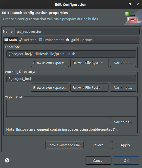

I have a script in my project that generates code prior to a build that works great. However, I'm trying to set up command line builds and I'm getting an error when I build from the command line:
Contains: Variable references empty selection: ${project_loc}
I tried to set this variable in the shell prior to building but no luck.
I can probably work around this in one of two ways:
  • Hard code the path to the project (but this may break build on other machines)
  • Disable the script and call it on the command line (but this break the build in the IDE)
Command line:
/opt/st/stm32cubeide_1.4.0/stm32cubeide --launcher.suppressErrors -nosplash -application org.eclipse.cdt.managedbuilder.core.headlessbuild -cleanBuild my_project/Release -data ~/stm32/workspace -D CMD_LINE_VAR
If anyone has any suggestions that would be great.
Builder setup:

Thanks for the tip. The environment variable ${project_loc}
doesn't work here so I have to hardcode the path to the script.
Interestingly this working path of this script is the {project_loc}/{Configuration}. I was able to get this to work by doing the following.
Make the path to the script ../ like this:
../utilities/build/pre-build.sh
Then in the script I have to back up to the project directory like this:
cd ..
This then allows the script to run in the IDE and from the command line builds while being agnostic to the absolute path to the project. This in turn accomplished my goal so that it can run on multiple computers and build both from the command line and from within STM32CubeIDE.

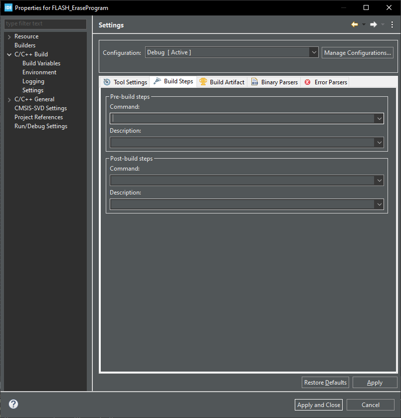

May be you could try to use the pre build step instead of the launch configuration.
The pre build step is intended to be use in this case.
