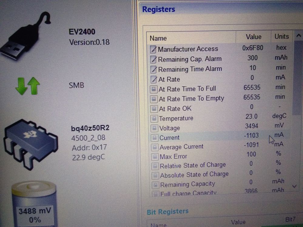

I am trying to get data of battery in stm32cubeIDE,I have taken voltage and temperature of battery successfully but when i was trying to get current of battery, it shows value like 65535 or 65473....like a garbage value.I am reading current in milli ampere.I also checked value on bqstudio as shown below image and it is (-1103mA),negative sign because it is discharging current.0690X00000BumPPQAZ.jpg

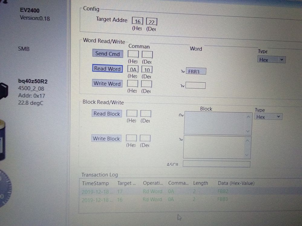

But when i send the register address of current in this same bqstudio,it shows garbage value FBB2 i.e.64434 same as showing in stm32cubeIDE. I have connected load of 5ohm and battery voltage is 3.5v .Please give me any suggestion.0690X00000BumRpQAJ.jpg

TRM in section 14.11 clearly states Min = –32767 mA, Max = 32768 mA, Word protocol and I2 data type, which is explained in section 15.1.2.

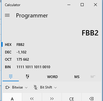

Thanks for your response sir,means i am getting current data in 2's complement form .Am i right sir?

Yes, the device returns signed 16-bit number.

@Piranha​ Thanks for your reply sir, and negative sign for discharge current ?
