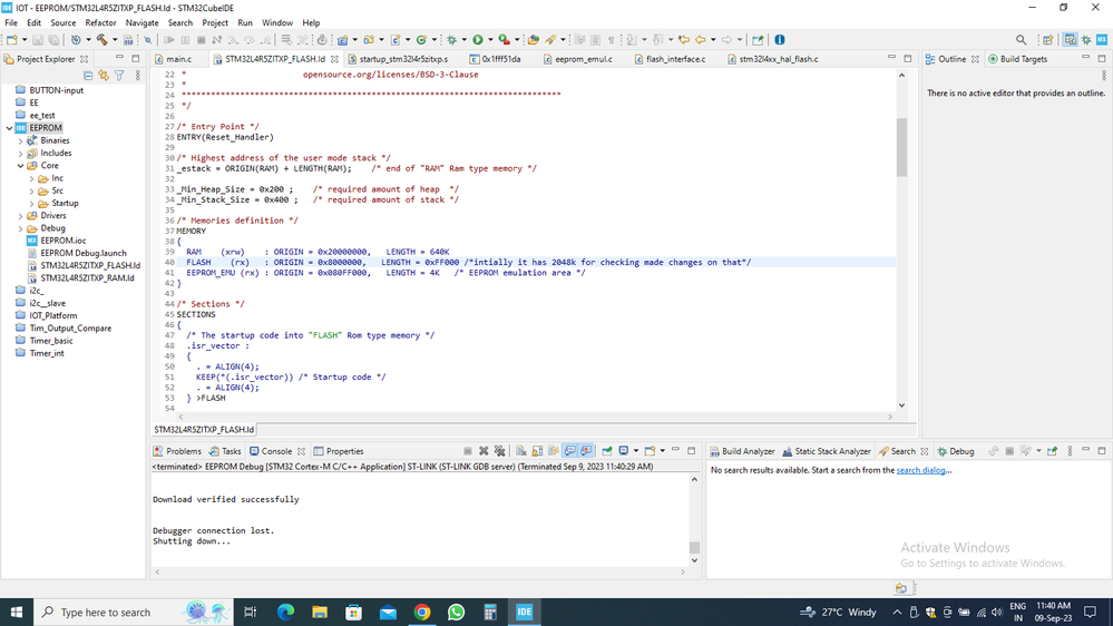

‎2023-09-08 11:15 PM
hello,
I have tried this shrink the FLASH but still facing same issue.
this way i have made changes is this correct or need to change, help me to debug this issue.
Thank you,

‎2023-09-09 4:32 AM
Documentation on this STM32 says that its flash page size can be 4 or 8 KB depending on some mode.
Are you in the right mode for 4KB page size as you assume?
‎2023-09-11 4:13 AM
hello,
Yes, I am using 4KB as a size.
Total Flash size is of 2MB,in that for EEPROM Emulation Using 4KB ,as mentioned in datasheet.
Do I need to go through with any other conditions to check?
Thank you.

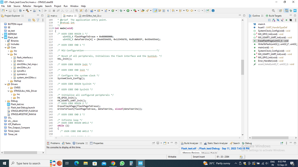

‎2023-09-11 4:47 AM - edited ‎2023-09-11 4:47 AM
Can you find and run some FLASH example for your board first, to verify that erasing a sector and write work correctly?
‎2023-09-13 3:13 AM
when I try to write to Flash I'm returning with an error=160.
Thank you,
‎2023-09-13 5:28 AM
@yashaswini Does this occur with a simple example (such as some ST Cube FLASH example for a similar board), not the "eeprom emulation"?
‎2023-09-13 6:20 AM
Yes, for simple example not for an eeprom emulation .
I have attached a snippet of that for reference, in this I'm trying write data to flash in that erasestatus it returns error.
‎2023-09-13 6:23 AM
‎2023-09-13 6:28 AM
You're erasing the entire flash in that example. You probably want type FLASH_TYPEERASE_PAGES. You're also sending what looks like an address as the page index.
Perhaps go off of a known working HAL example.
