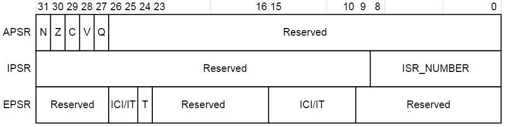

I'm seeking for the following information:
  1. What is the CPU flag/control& status register (CSR) called and
  2. where - ST document - is it documented?
  3. Looking at the STM32Cube IDE debugger view (gdb register view)
what is this register called and where are the Carry, Sign,Zero etc.
bits?
Nikita91
Lead II
Download and read the "Programming Manual" for the MCU Family you use.
The ARM core registers are explained.
The d0-d15 and s0-s31are the floating point registers

CPU registers will be part of the ARM Core - so will be documented in the ARM documentation; eg,
https://developer.arm.com/documentation/dui0552/a/the-cortex-m3-processor/programmers-model/core-registers?lang=en

How do they correspond? What are the bits for C,Z,S etc. in the PSR (xpsr)?
What do d0-d15 resp. s0-s31 stand for?
Andrew Neil
Also get hold of a copy of Joseph Yiu's "Definitive Guide" book for whichever core(s) you're using...
