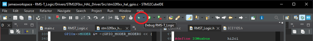

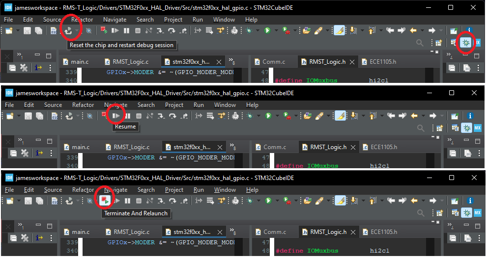

I've been using Keil MDK for the last year. My license is going to expire, and I am going to ramp up who needs to write firmware from 1 to about 5. So, I am going to revert back to STM32CubeIDE. There were a couple of useful functional processes I used in Keil that I can't seem to replicate with CubeIDE.
First)
In Keil I was able to reset the processor and the debug session would start back at main().
There is a "reset" button in CubeIDE but it doesn't seem to restart the debug session. It seems to stop the code wherever it is, but I can't do anything. Step over, step into, continie all don't do anything. Under the debug window (left) it shows "Thread #1 (Running: User Request)".
I cannot seem to interact in anyway.
Second) In Keil, when I was running a program I could press "Stop" and execution would stop exactly where it was happening and then I could take control of the debugging. I found this to be useful. I can't seem to find an equivalent.
Thanks!

When you are in debug mode these buttons (circled in red in attached screen capture) will do what you need. Button on upper right corner puts you in debug mode.

This button starts the debugging of your code. In below screen shot, it will start debugging the project "RMS-T_Logic"
jgauthier
Senior
Thanks! I didn't see that button. I will look for it.
