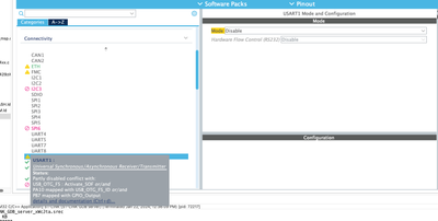

I am running CubeIDE on OSX (not sure if t hat makes a difference)
In the pinout & configuration you can see that some of the configured items, for example ETH and USART1 have a little green triangle next to them, indicating what I believe is a conflict.
If I hover the mouse over the icon, in just the right place, it will show a popup, but, no matter what I do, after a second of being visible, the popup disappears again, so I do not get long enough to read what its telling me, thus cannot figure out what I am being told.
Is CubeMX really this buggy/ Is there some other view I can look at that will give me information about these conflicts so I may try to resolve them?

If you talk about the yellow triangle ... :)
- this is only a warning, not all modes or pins available, because you already used some of them.
You anyway see details, when you click on the yellow marked thing, here your usart1 :
(mode , also yellow) will show you, whats available, or not (red). Thats all.

Unfortunately, clicking the icon does not show any addtional information, I guess thats an OSX thing.  I did manage to grab a screen shot as @TDK suggested, so can see the error now. I cannot of course click on the documentation link to get more help.  Unfortunately as a noob to these STM32 devices I really can only guess at what this even means,
Also, appreciate they are only warnings, thank heavens,,, if they were errors I would not only not know what they mean but the project would not work either lol
Misunderstanding - not ON the icon, just ie in usart1 "mode" click in the selection box "disable" , then you see , whats (still) possible or not.

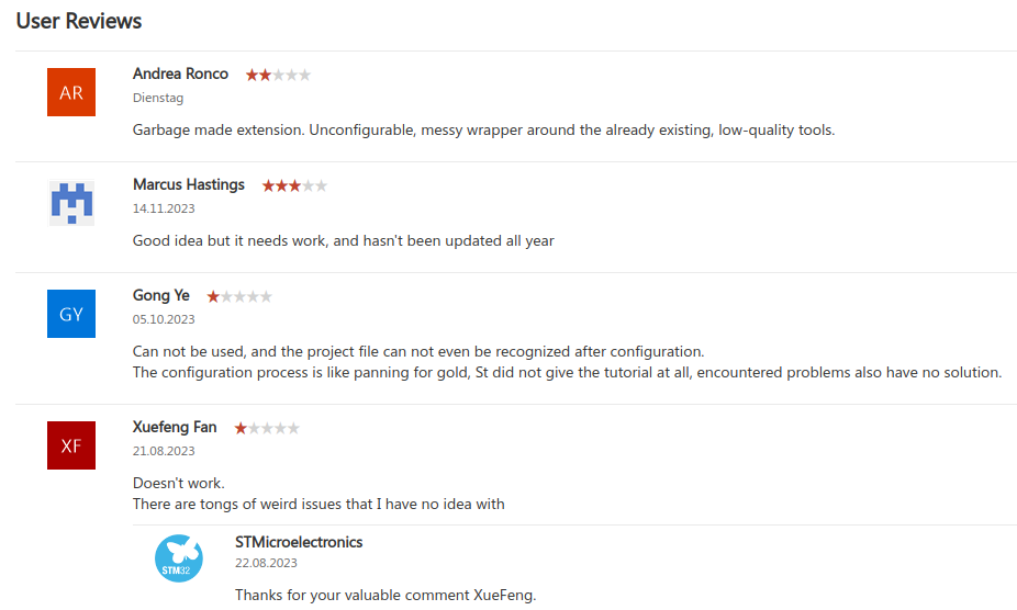

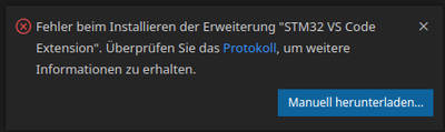

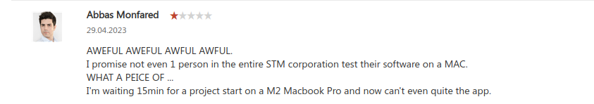

My test on VScode with STM was surprisingly short :
... no install at all, after 5 minutes "thinking" (progress bar seems very busy...).
Also other user comments are ... :
