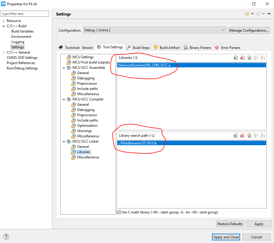

Cartu38 OpenDev
Graduate II
February 10, 2020
May help maybe ... some binary inclusion setup example from AI pack usage. Let's promote your own material this way...0690X00000BvtszQAB.png
