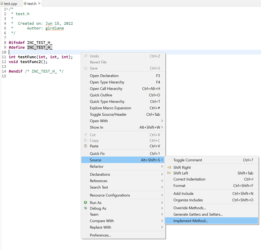

‎2022-06-15 1:48 AM

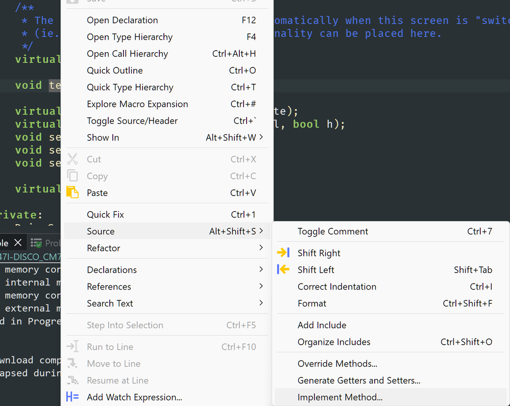

I tested it with a C++ file and nothing happens when I click on "Implement method":
Here's where I right click:
The file is saved, the source file exists and I can navigate to it by both "switch header / source" and pressing F12 (F3 with original bindings) on an already implemented method.

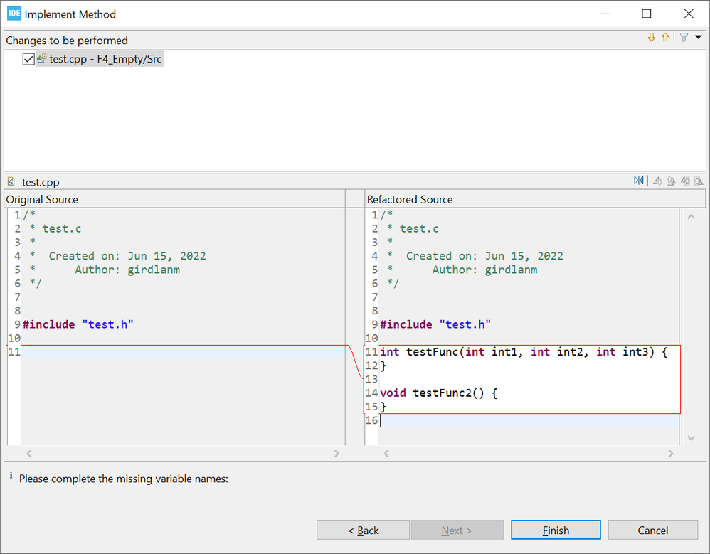

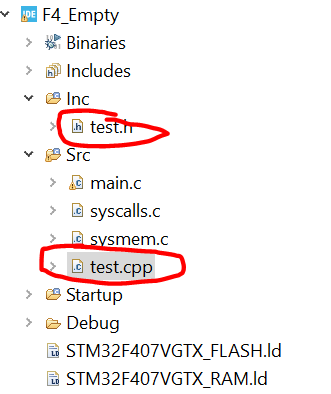

Hmm, that seems odd. Did you "convert" the project or do you have a source file with .cpp?
I haven't used this method before, I just ran a simple test when I read your question earlier today. Here's how I did my test:
I set up an empty C++ project for an F4 discovery board and just added a "test.h" and "test.cpp". From the test.cpp I added a simple
#include "test.h"
This made the project structure look like this:

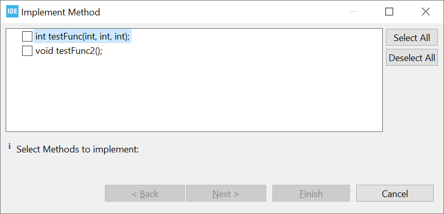

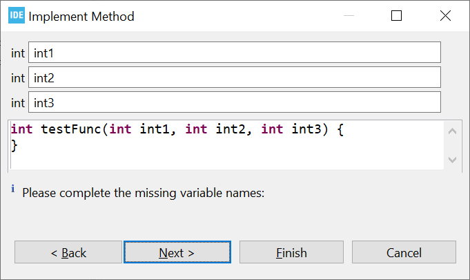

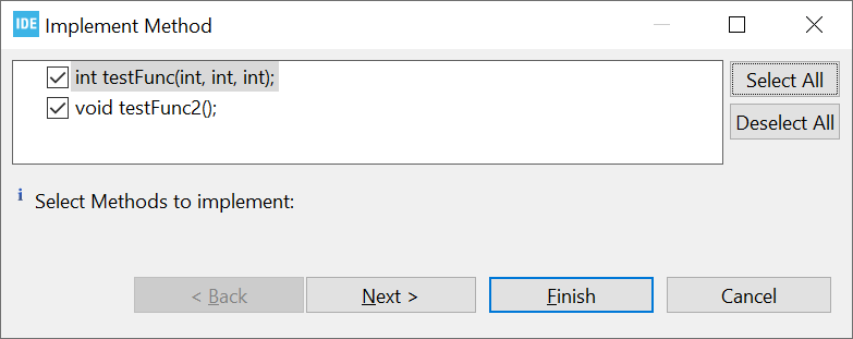

I set up two test functions in the header file:
This allows me to use the Implement Method option:
This then gets added to the test.cpp:

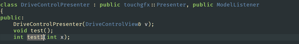

‎2022-06-15 2:30 AM
And here's what I got when I try to use implement shortcut I've just made on .cpp file:
While still in the .hpp file I have:
‎2022-06-15 2:35 AM
Did you use the "Implement Method" shortcut when you have the .cpp file or .hpp file selected? It seems to make a difference in that you need to do it on the header file.

It's already C++ project, created with TouchGFX. My header is .hpp, since it's a part of the GUI that is mostly C++. There is a bridge between C and C++ code, a one linking class that calls C function, but it's not the one I test it on. I test it on a regular C++ class that doesn't DIRECTLY link any C code (except one of the partner header references a .h header, naturally).

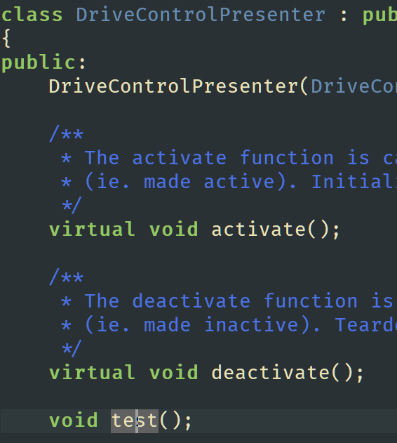

‎2022-06-15 2:39 AM
What's even weirder, here's .hpp part that is NOT IMPLEMENTED:
It compiles without errors or warnings.

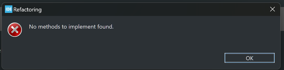

‎2022-06-15 3:11 AM
I tried both. In .hpp it does nothing, in C++ it shows "No methods to implement".
