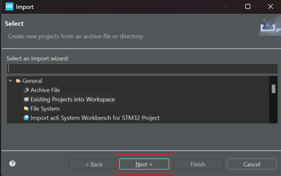

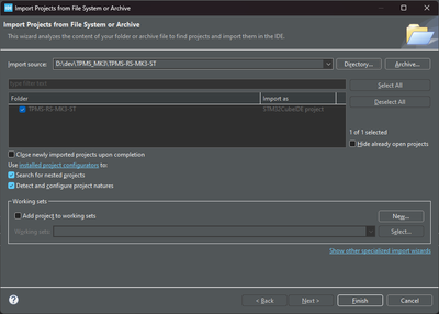

some time when I try to import an existing project in file system into workspace every thing looks to work properly it find the project show the project name in the list

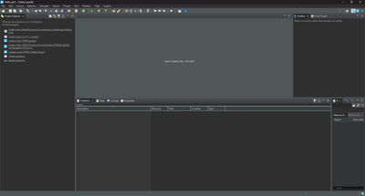

but when I clic finish it never show in workspace

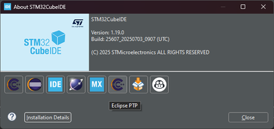

here my information using 1.19 release of cube ide on a windows 11 host

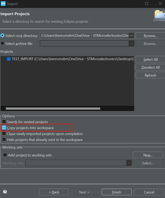

You need to click on Import , Next. Then enable [Copy projects into workspace].
Thanks.
