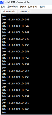

Hello everyone I am new to the STM boards I had received my board today I had tried the basic LED toggle code and it is working fine but can someone please guide me to see the debug message on the code like I can see the printf statements how can I see those debug messages can someone please help me.

Thank you for the reply,I had used the Renesas microcontroller which will be using the Segger RTT for debugging.I would like to know is there any way of debugging the controller like that
Yes, you can use Segger's RTT on STM32.
See the Segger documentation for details:
https://www.segger.com/products/debug-probes/j-link/technology/about-real-time-transfer/
It's proprietary to Segger so, if you have questions about Segger's RTT, you need to ask Segger:
https://www.segger.com/support/technical-support/
https://forum.segger.com/
PS:
Note that RTT relies on J-Link - it won't work with ST-Link (or other debug probes)
Thank You @Andrew Neil  I can able to debug using JTAG in my STM board
