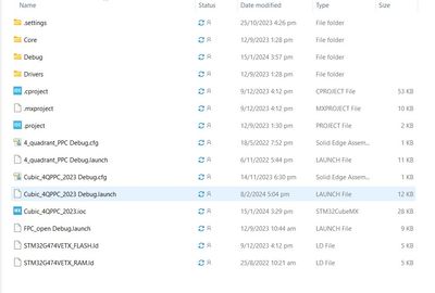

I deleted all these files and imported only project files, but again facing such issues.
Thank you
I have attached a picture showing all the files from the previous system.
Can you suggest to me which files should be deleted in the new system?
Thank You
Neelesh
