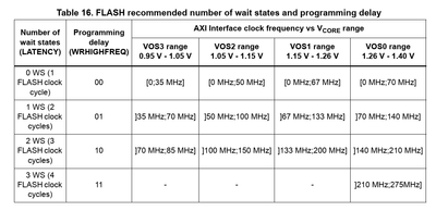

see flash/wait for H723 :
If i read this, i'd say: you need 2 WS at 275MHz core . (same as on my H743 )

CUBEIDE doesn't let me modify the FLASH-WaitState, there is an asterix, poinnting to the statement "the setting is adjusted automatically when the Voltage-scale is set" (or something similar). I'm amazed about the relation, by trial and error I found the following relation:
    - Volt scale 0    3WS (4 CPU cycles)
    - Volt scale 1    0WS (1 CPU cycle)
    - Volt scale 2    0WS (1 CPU cycle)
    - Volt scale 3    0WS (1 CPU cycle)
I tried a debug session with Volt scale 1: the previous error showed up again. Then, with setting 'Volt scale 0' => 3WS my problem looks to be solved. I got another error, now something with SPI, but not the repeating line 1139 of file 'stm32h7xx_hal_rcc.c' !
