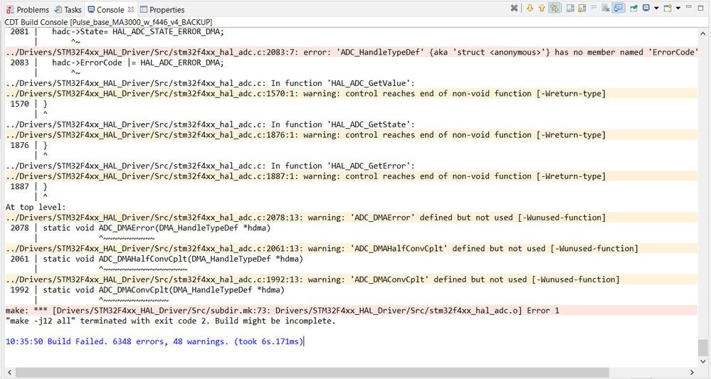

I have a project in stm32cubeide that I have been using and updating for a while and have not had any issues. Now however, I get
10:35:50 Build Failed. 6348 errors, 48 warnings. (took 6s.171ms)

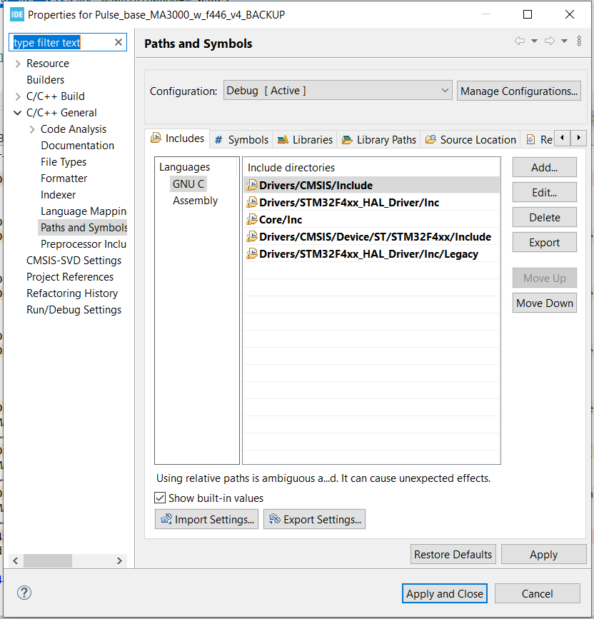

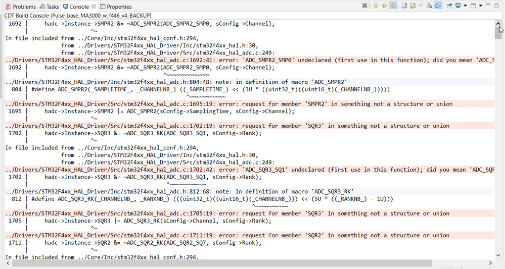

Looking at some of the errors, it ranges from undeclared variables, to not recognising number formats. It looks like a driver or path issue but the paths look OK to me. Cleaning the the project and rebuilding does nothing. Here is a screenshot of some of the errors and the path:
Any suggestions as to what I could try next would be appreciated.

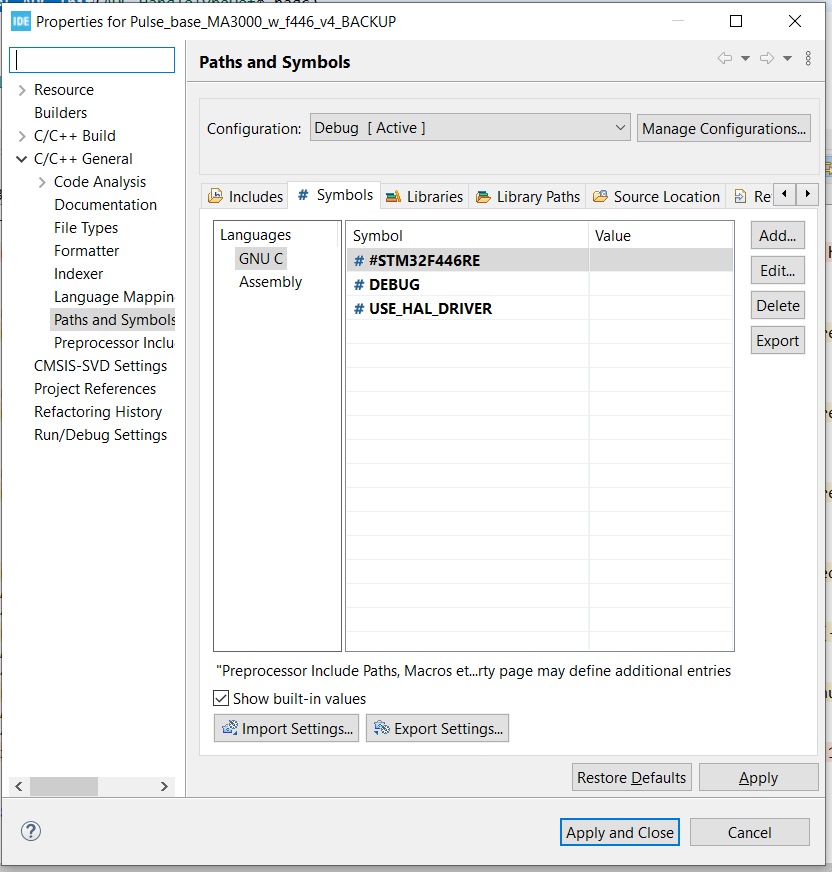

In your path there is STM32F767 but the screenshots shows STM32F446...
In the 1st screenshot there is #STM32F446RE., Try STM32F446xx
Without # and without RE

Take care that the project root folder is on a short simple path, not containing spaces, non-ASCII chars or other difficulties.

I knew it was going to be something simple. Good eye, it was indeed an incorrect symbol. Thanks!
