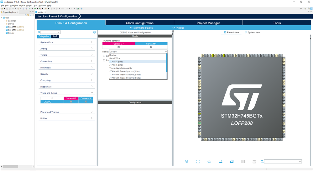

I am using the STM32CUBEIDE , I am working on STM32H745 series , I have to programme the device using JTAG .How I can done that which application I have to use for progrraming what setup I have to done in stm32cubeide ? Can u please help me

The debug mode can be selected from the ioc file,
You need to change the CubeIDE debugger settings as well, please check AN5286 STM32H7x5/x7 dual-core microcontroller debugging, it contains detailed steps to debug H7 dual core devices.

CubeIDE will do programming as part of starting a debug session.
Or you can use the STM32CubeProgrammer (the clue is in the name) to just do programming.
https://www.st.com/en/development-tools/stm32cubeprog.html
Or you can use any suitable 3rd-party programmer; eg, Segger have support:
https://wiki.segger.com/STM32H7

In stm32cubeide in debugger option what changes I have to make?
