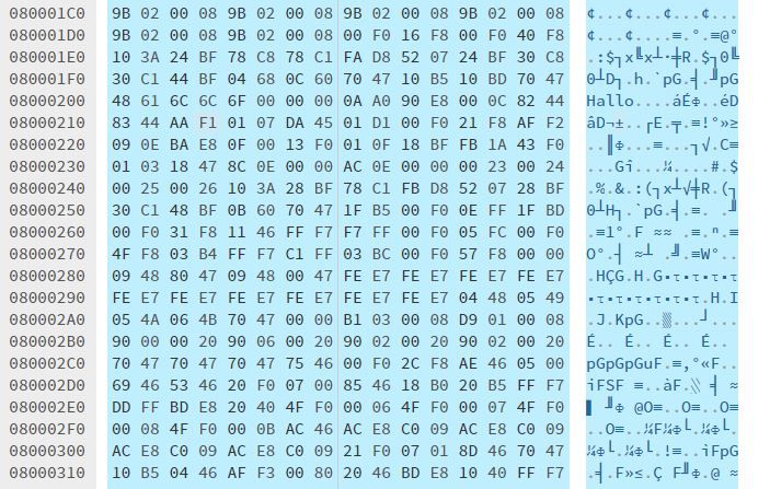

I have an issue to place a ASCII string in flash when using CubeIDE and the GCC compiler:
#define APP_INFO_ADDR_2   ".ARM.__at_0x08000200"
const uint8_t my_text[] __attribute__((section (APP_INFO_ADDR_2))) = {"Hallo"};
when I compile this code (no opimization), I get no errors, but at the hex file at address 8000200 there is no "Hallo" string located.
When I compile the same code with µVision and the Keil Compiler it works.
0693W00000aJBspQAG.jpgI also searched for this issue and the only working solution I found is, to define a separate section in the linker script and then place this string in this specific section.
But to change the linker script for this task is not my preferred way.
So the question for the community here is:
What do I need to change here to see also this ASCII string in the hex file, when using GCC and CubeIDE?

First, as you mentioned, it is possible to modify the linker file.
Since, you don't want to change it, you can try to use .rodata section to insert a constant read only string. Then, you should use it in your code. Otherwise, it will be deleted.
const char my_text[] __attribute__((section(".rodata"))) = "Hallo";
If this solves your problem, please mark my answer as "Best Answer" by clicking on the "Select as Best" button, this can be helpful for Community users to find this solution faster.

BKain.2
Hello Firas,
Thanks for your feedback. Unfortunately your proposal does not solve the problem.
This
__attribute__((section(".rodata"))) does not put the sting into any
flash place.
In the meantime I found an similar topic
here:
https://community.st.com/s/question/0D53W000014wt4KSAQ/placing-string-in-a-fixed-memory-address-on-flash
The main problem is, that the GCC compiler ignores this section ( ".ARM.__at_0x08000200") or your proposal:
(section(".rodata")
I found now a fix (workaround), that this section ( ".ARM.__at_0x08000200") is supported by both compiles,GCC and Keil.
The trick is to define in the GCC linker script a section with the same label name  .ARM.__at_0x08000200 like the KEIL compiler supports correctly.

The mainstream GCC does not have __attribute__(("at")), or the mainstream GNU linker does not support it. This attribute is Keil specific.
IIRC the ​ GNU linker cannot even define a segment at absolute address that collides with any region in the MEMORY {} section.​
@BKain.2​ As Firas wrote, you need to make a reference to this data, else it will be removed as unused.
