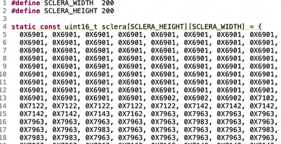

Hello Community,
I have several really large const arrays (with graphics data for LCD displays) which need not to be copied into RAM at startup, as this overflows my available RAM (on STM32F411 Discovery board). As there is no way to configure such behavior in STM32 Cube IDE I have tried to modify the linker scripts but GCC linker keeps ignoring my modifications.:face_with_rolling_eyes:
Does anybody have experienced the same problems or have some ideas how to convince the linker not to copy that sort of data into RAM? Data access speed is no issue as the speed bottleneck is in any case the display (connected via SPI).

I suspect there's another issue here, perhaps a different array.
Reduce the size so it works and show the RAM .data section to show that it actually makes it in there. The screenshot doesn't show anything, just that some data is copied over, which it should be.

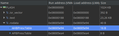

AScha.3
In STM32 target hardware(that is in our embedded hardware), all global const variables live in FLASH memory.
By default, all global const variables will be stored in read-only memory or the FLASH.
<  from: https://fastbitlab.com/microcontroller-embedded-c-programming-lecture-130-placements-of-const-variables-in-memory/

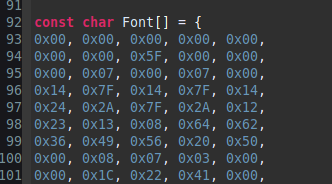

so, what did you write?
ie from prog on stm32f103 : graphics font for tft
and in mem:

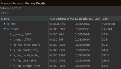

ok, so for F411 board:
and (with unmodified settings)
const var -> in flash. only.
(here a flac+ mp3 decoder running, tables never would fit in his small ram)

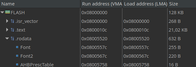

++ found F407 prog now:
gives

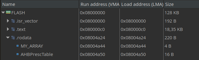

try..
last idea:  try to give the place...  (not sure, that i write it correct)
__attribute__((section(".rodata"))) const uint8_t MY_ARRAY[] = { 1, 2, 3, 4 };
makes
