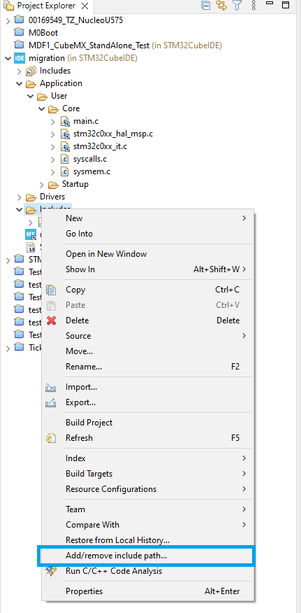

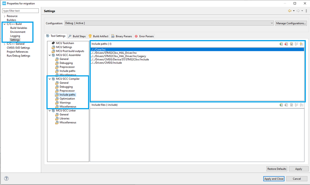

As mentioned by my colleague @KHALSI_Foued​  the only way is to create a project based on the same MCU and copy the code manually.
Make sure after adding new files to add the header files to the include path settings.
You can access this parameters by right click on the project the properties:
Or the easier way is to right click on the new folder containing header files and select "Add/remove include path..."
Hope this reply help you migrating your project.
