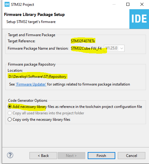

Looking at full log i have noticed you have updated all default paths.
1) custom IDE product install path​
2) custom FW packs install path
3) custom project root path
Back all such should be supported but ...
On top of 1) and 2) both are sharing a common path root what may be even more specific.

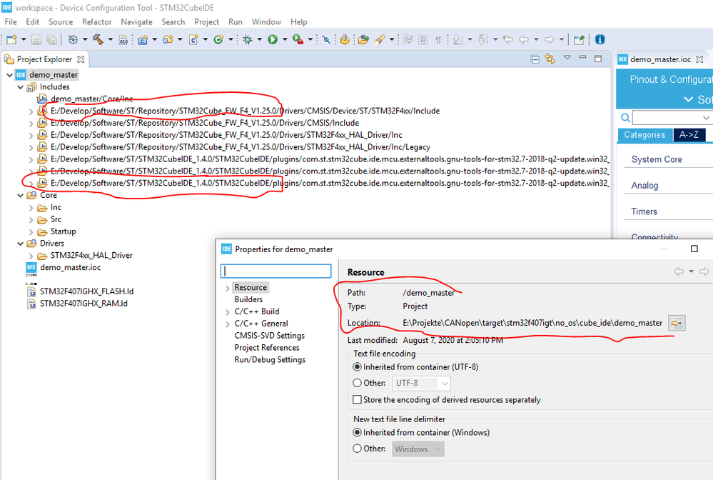

I have created once more a new project with CubeIDE V1.4.1. If I press the button "Finish" in the project configuation dialog then the project creation starts and
I see the icon in the project tree window.
But then the icon disapears and also my folder "demo_master" where normaly should be the file *.ico is deleted. In the
project configuration dialog is it possible to press the button "Finish" again and again and the procedure is restarted always with the same result.
The logfile says the path "Develop/Software/ST/Repository/STM32Cube_FW_F4_V1.25.0/Drivers/STM32F4xx_HAL_Driver/Src/stm32f4xx_hal_tim.c"
is not a valid location. Indeed, this is correct because the drive letter is missing in the path. But why is the drive letter missing here? I have attached a screenshot where you can see that the path is correct on my PC.
"D:\Develop\Software\ST\Repository\STM32Cube_FW_F4_V1.25.0\Drivers\STM32F4xx_HAL_Driver\Src\stm32f4xx_hal_tim.c"
I have also checked this issue on my second PC here. It also runs on Windows 10 x64 and a can reproducre the issue
also there. I have also installed the tools and the repository into the default paths but without success.
