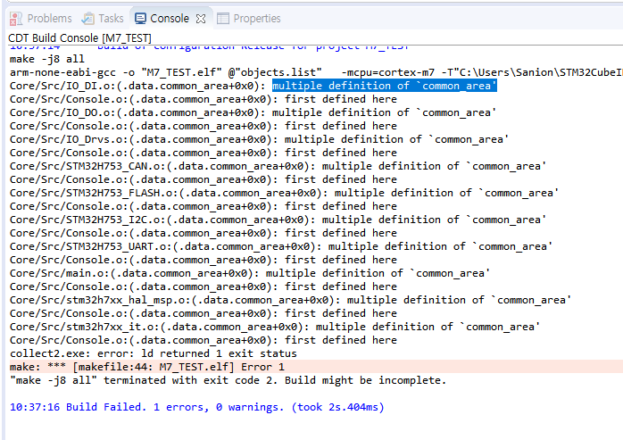

2020-04-20 6:49 PM
@berendi
Thank you, berendi.
I tried as you said, and my code uttered an error.
For reference, I placed the structure in DTCMRAM.
Next is my .ld file.
MEMORY
DTCMRAM (xrw) : ORIGIN = 0x20000000, LENGTH = 127K
ITCMRAM (xrw) : ORIGIN = 0x00000000, LENGTH = 64K
RAM_D1 (xrw) : ORIGIN = 0x24000000, LENGTH = 512K
RAM_D2 (xrw) : ORIGIN = 0x30000000, LENGTH = 288K
RAM_D3 (xrw) : ORIGIN = 0x38000000, LENGTH = 64K
FLASH (rx) : ORIGIN = 0x8100000, LENGTH = 2048K
I also made the structure as follows.
struct common_vars {
uint8_t a;
uint8_t b;
uint8_t c;
uint16_t d;
} *common_area = (void*)(0x20000000 + 127*1024);

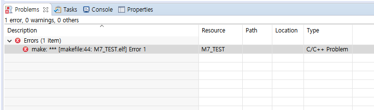

This is an error message that occurred to me.
I don’t know what’s wrong with you. Do you know what’s wrong?

2020-04-20 9:01 PM
@Community member
I defined a structure in a single header file.
This header file is included in several .c files that require this header file among the source files in the project.
I think it's a matter of redefinition every time it's included, but I don't know how to solve it.
2020-04-20 11:06 PM
Separate the type declaration, variable declaration, and variable definition, as you would with any other variable that is used in more than one compilation unit.
2020-04-20 11:22 PM
@berendi
If you don't mind, can you give me an example?
2020-04-20 11:25 PM
type definition:
int a, b, c;
variable declaration:
extern struct common_vars *common_area;
The above goes into a header file. The variable definition goes into a .c source:
struct common_vars *common_area = (void*)(0x20000000 + 127*1024);
2020-04-20 11:53 PM
Thank you, berendi!!
Thanks to this, I was able to confirm that my program was working normally.
