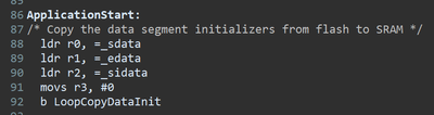

Jump from one application to another was successful. But the obvious problem here is that data segment initializers copy from flash to SRAM of APP_2 and APP_3 will be performed repeatedly in a loop. I thought of a few ideas like: skipping the copy instructions in the startup code from the 2nd loop onwards, but I'm stuck. I don't find any commands related to _sdata, _sidata... or bss in the startup file generated by STM32CubeMX.  Is there some hidden code associated with the current startup file? Can I create a custom startup file to replace the current startup file?

The default startup file generated by CubeMX initializes SRAM appropriately and uses the _sdata and similar variables. For example, here is an excerpt:
The startup file is typically named startup_stm32*.s
You can, of course, modify the startup file however you want as long as you do the necessary things inside of it.
Edit:
The _sdata and similar get defined in the linker file, which depend on the sections you define in there. Maybe that's what you're missing. You'll have to ensure the sections for each program do not overlap at all, then it should just work.

But APP_2 and APP_3 run in turns. You must allocate separate data areas for APP_2 and APP_3 else they will overwrite data of the other app. If their summary data size does not fit in the physical RAM, you'll need to save the data of one app before jumping to another.

Thank you for the valuable information for me. I found them in Cube IDE. However, in Keil there is no linker file, instead I found a scatter file. Maybe it is not possible to create branch conditions in the scatter file?? Can I create a linker file to replace the scatter file?

In your code snippets above, no changes in linker or scatter files were needed. Just set correct ROM and RAM addresses for each app in Keil project options and you're done.
