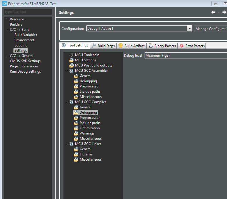

i would like to create a static lib with cube without any debug information (this is to share with third party)
I have created static lib and add it to another project and call API(function define in lib), during debug it is showing complete c code, hiding c code would be sufficient in this case.
I tried with adding object file instead static lib .a but result is same.
I read somewhere that during static lib creation uncheck “debug information�? option but unable to locate it in the STM32cudeIDE.

‎2023-02-09 1:23 AM
Hello @PGhat.2​
The UM2609 STM32CubeIDE user guide contain a description on how to create static lib.
Check the chapter 2.2.2 Creating a new STM32 static library project.
Hope this response helps.

‎2023-02-08 5:03 AM
maybe , look in Project -> Properties ...
