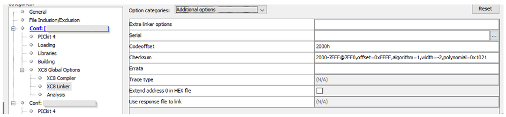

In MPLAB it is done like shown here:
0693W00000UnoIXQAZ.pngSo how do I do this in CubeIDE?
