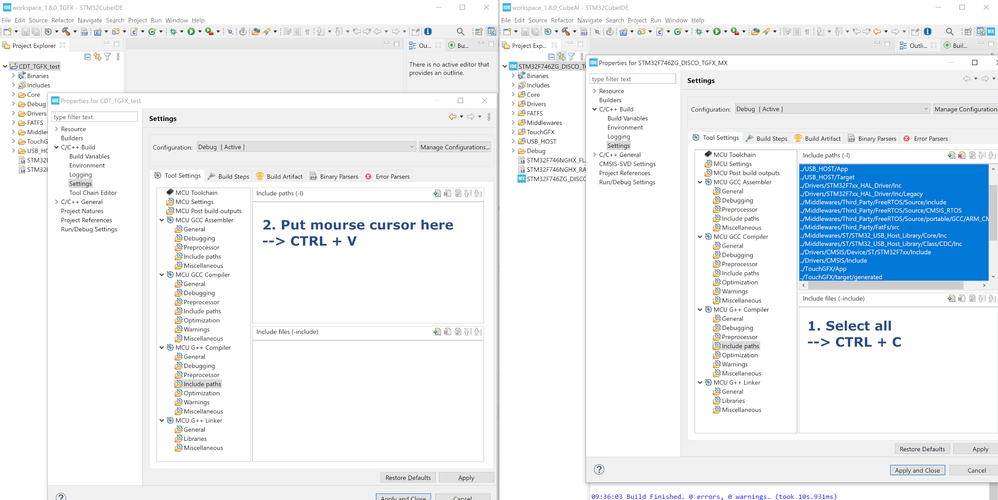

Ohh... There is no "automated process" for this. But I have a couple of things that makes life easier.
You are going to have to copy both files and settings manually from one project to another. It might be easier to launch two instances of CubeIDE when copying the build settings. File copy is easy drag-drop in one IDE instance. But for build setting you can only have the build settings dialog of one project open concurrently. Hence I would say start the new CDT project in a new workspace initially. Especially if your migrating many projects from MX to CDT :)
My migration process would be roughly (maybe I already wrote it in another thread?):
  • Create a new CDT project: File > New > C/C++ Project > C Managed Build > Empty Project > MCU ARM GCC > ...
  • FOLDERS / FILES: Drag and drop over the folders / files you need
    • CAREFUL:
      • Make sure you "copy" folders/files instead of moving or creating links...
      • This also assumes that the project you are copying from contains the files you need physically! Not linked resources.
  • BUILD SETTINGS:
    • CAUTION: Be careful to which build configuration you copy each settingto assuming you have at least a Debug and Release config...
    • Try to batch copy-paste settings:
0693W00000JOWvXQAX.pngYou can do the same thing with symbols
The rest of the settings has to be reviewed manually. But t least this will simplify the most painful exercise...
  • BUILD: Build your project. Typically one has forgotten some thing and the build will fail. I tend to forget pointing out the linker script...
    • This is an interative process until you have a successful build!
    • Then compare the build result vs the MX project. Is the text/data/bss section identical in size? If so there is a 99% chance you have an identical project migrated from MX to CDT. If not, diff the map-files!
  • DEBUG: Generate debug configs and try the proejct.
That to me summarizes the workflow. This is complicated if you rely on additional tools to generate code like TouchGFX Designer. Then you may also need to re-consider how/where this tool generates files and how to best manage them in the new project...
Also people starting from example projects with linked resources cannot really follow this path. The linked resources are the obstacle which will making copying files impossible. But the linked resources can be resolved if the example is imported using the MCUFinder/CubeMX wizard in CubeIDE isntead of the normal Eclipse import frameworks. I hope that makes sense...
