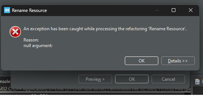

It's a pretty common need in an IDE to be able to branch or "fork" a project. Normall, I'd make a copy of the projet at the file level, then rename the original and continue development on that. However, Ranaming a project not only crashes, but also leaves the project broken: I don't see any "Save Project As" Option either.
I could make a copy and find every refeferenc to the project's name and change it, but this is tedious and error prone. Is there some way to do this I'm not seeing??
Error message I got when I Right-click project and "Rename"

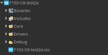

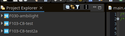

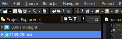

Just try :  in IDE , left side, click on a project (selected = blue) , right click on it and select > copy< .
then (on empty space i did) : right click and select > paste < .  -> give mod. name for new copy ->
open here,  right click on xx.ioc and select > rename < .  -> give matching new mod. name for new copy
also rename xx debug + xx.launch

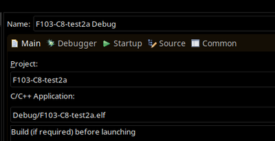

+ in debug configurations ..main page for new debug->
rename Name , Project, xx.elf
Then mod new xx.ioc , gen code, compile.... and TEST debug. :)
