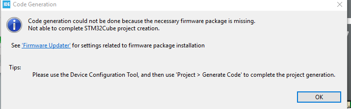

AGupt.0
0690X000008a70lQAA.pngNot sure why but now I am getting this message when I try to create a new project to start from scratch, what to do with this one?
