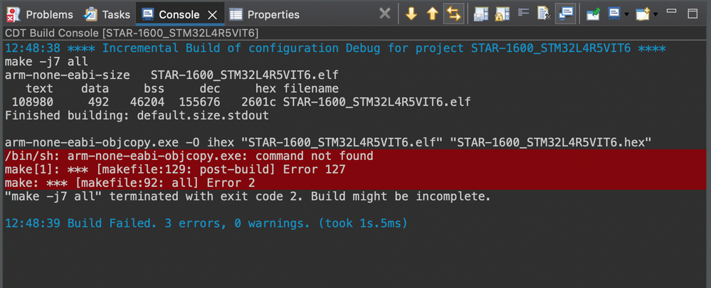

But I have another problem encountered. I will attach a picture of the error. I'm using STMcubeIDE on macOS. 0693W00000SwD79QAF.png

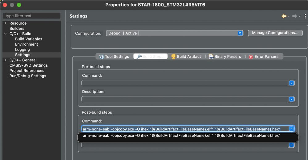

Presumably this is an already prepared project that has been set up on a Windows computer. The person had inserted a command to create a HEX from the ELF file that uses a Windows executable, which of course does not work on your Mac.
However, it is not necessary to do this there as a post-build command (already because of the platform dependency), so you can simply delete that command:
Project > Properties > C/C++ Build > Settings > Build Steps > Post-build steps > Command
The STM32CubeIDE offers a dedicated option for this:
Project > Properties > C/C++ Build > Settings > Tool Settings > MCU Post build options
and tick Convert to Intel Hex file
