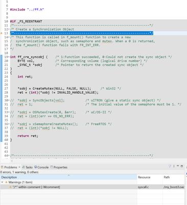

Does anyone have any idea how to fix this warning ?

The comment in line 12 was not closed. You are opening a comment within a comment (of line 12).
