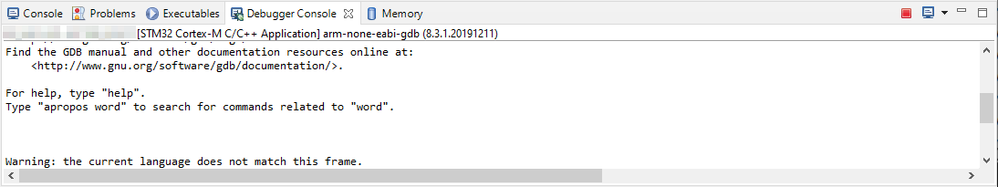

However, when I click Run > Debug, and I finally get a connection to the debugger, I cannot see these printouts anywhere -- at least not in the Debugger Console, where I'd have expected they would appear:
So my main question is:
- Is it possible to use gdb commands like echo and printf in the gdb script in Debug Configurations' Run Commands -- and if so, how? (is there some additional setup; is the Debugger Console the right place to look for these output printouts?)

1.It was not quite obvious to me, but you can type in the Debugger Console, once the debugger is halted on a breakpoint; here echo and printf work just fine (however, then you are in the gdb client, so to speak):

About "Run commands" and printing to "Debugger console". This is not possible. Because CubeIDE opens two channels to the GDB-client.
- The "Debugger console" has its own pipe/channel to the GDB-client to allow interaction with target.
- All other CubeIDE communication with the target under debug is managed via MI (machine interface). For example "Run commands" when launching debug, or when you click step/halt/... So to see your echo output from the "Run Commands" you can enable the GDB traces. Window > Preferences > C/C++ > Debug > GDB > checkbox "...show GDB traces..."
Hope it clarifies part of the mystery.
