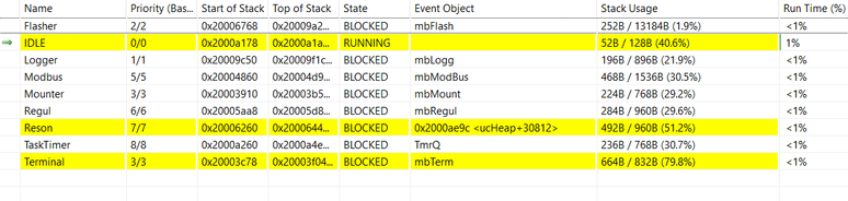

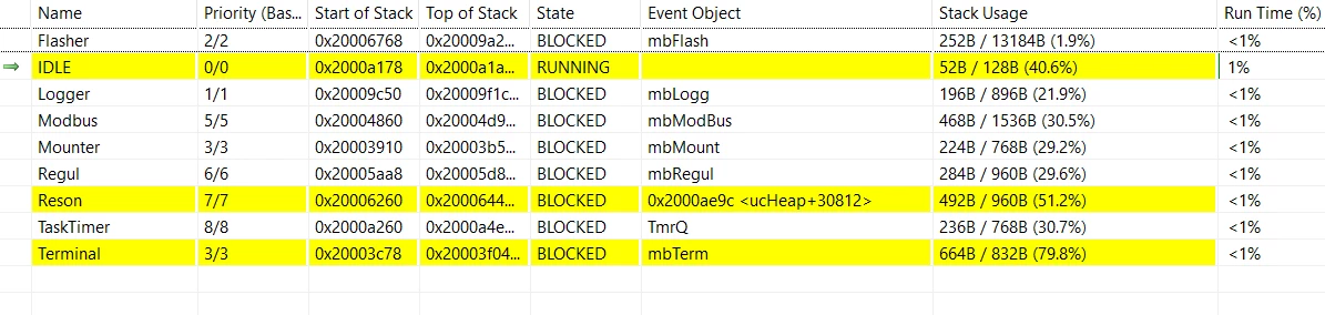

Hi
Using FreeRTOS V11.0.1 and Stm32Cubeide 1.14.1 I was trying to read out the percentage information into the debugger.  Unfortunately I don't get the expected behavior
As all of my tasks are either below 1% or at 1%, it does not seem correct.
I have followed the instructions in stm32CubeIDE user guide and if I make a call to
uxTaskGetSystemState
 from the FreeRTOS API, i can calculate values that make more sense as the IDLE task now takes up about 99% of the time under no load.
Are there any other settings that needs to be fulfilled for this to work or are there any more needed configurations in FreeRTOS?

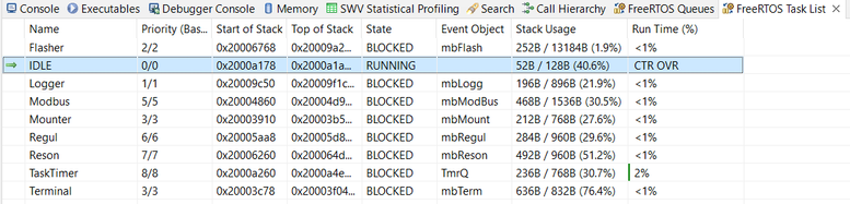

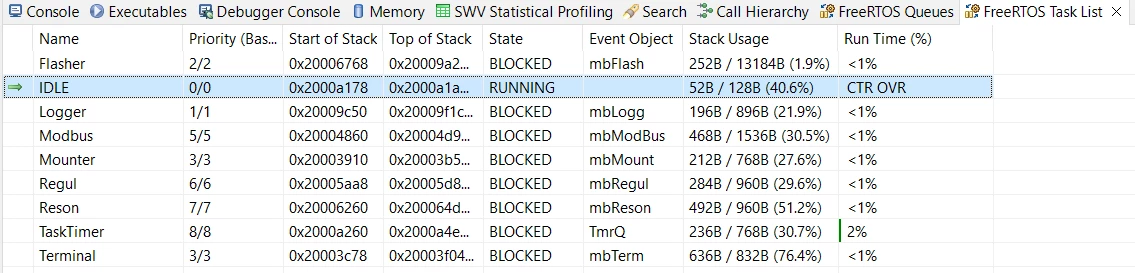

    Hi KnarfB and thanks for the reply.
    I will dig in to my implementation and what I got later today. But I tested your variant, which I prefer since I dont need to assign a normal timer and have a timer update event interrupt that executes.
    When I run with your code instead get this:
    Which looks reasonable apart from the "CTR OVR" for the runtime.
    Best regards
    Martin
    KnarfB
    January 29, 2024
    No idea, where the counter overflow comes from, maybe you have to add a
    DWT->CYCCNT = 0;
    in the init phase or the MCU clock is soo high (or tick rate so low)? Never seen that before.

    This was broken by multicore support in FreeRTOS kernel, commit https://github.com/FreeRTOS/FreeRTOS-Kernel/commit/ae3a498e435cecdb25b889f2740ea99027dd0cb1.
    Since data from uxTaskGetSystemState looks correct, most likely Cube IDE needs to adapt.
