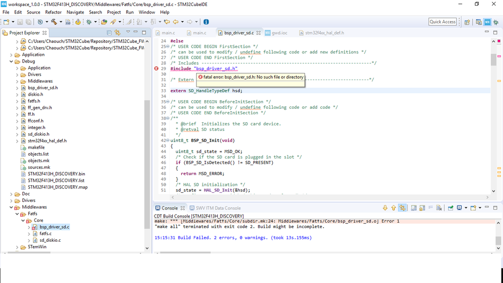

Hi ST Community,
as you see in the pic below I have a problem with bsp_driver_sd.h
I created a new folder called Fatfs and in this folder a new one its name Core , I put the source file as shown, I ceated the header file (bsp_driver_sd.h) but i still don't understand the problem.
Clive Two.Zero save me please! thanks

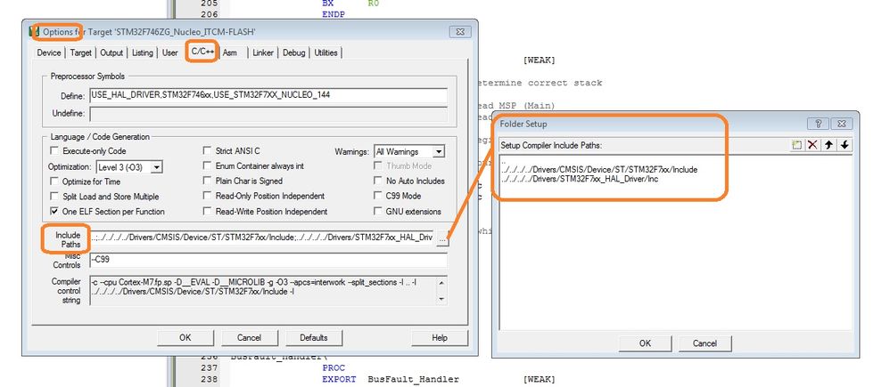

The compiler expects a list of "Include Paths" which I can use to search/file the files. Typically in the C/C++ Compiler options tab for the project, sorry not using CubeIDE
Whatever the path to bsp_driver_sd.c / bsp_driver_sd.h is, add that to the list
idrissmc
Which list do you talk about?
and if I created files wherever in the project, the compiler wont be able to see them?
if yes that’s hard to know in which folder I have to put the file!
i can’t understand the point with “include path�?
Standard compiler stuff from 40+ years, so you don't have to replicate all the library includes in your singular project directory. You tell the compiler where to find them, and it goes and looks.
