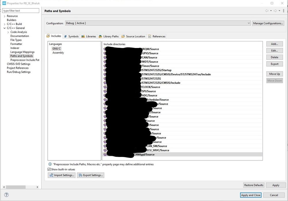

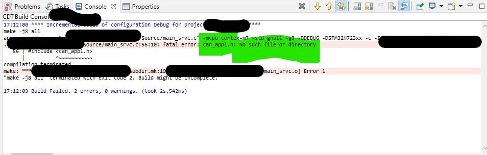

Hi everyone,
I started getting fatal error for the file which is in the project location. I have also added the path in the IDE.
I am attaching the screenshots which might be helpful for you to provide the solution.
Sorry for the rubbish image. Had to do it so for a reason.
Regards
Arrhenius

‎2022-03-24 6:14 AM
Does the file exist? Where? Is that location included in your path?
Could also be an issue with spaces or non ascii characters in path.

‎2022-04-08 3:16 AM
Hi @Markus GIRDLAND​ and @TDK​ ,
I found the solution to the problem.
The issue was in the include paths updated in the project properties were not reflected under folder hierarchy.
I used export option and that's all. It started working.
