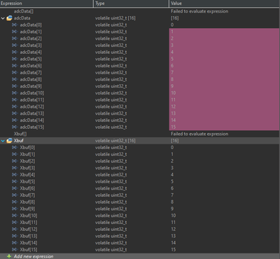

Failed to evaluate expression
‎2024-03-22 3:52 AM
I have tow arrays one named adcData[] that is adc input buffer and Xbuf[] that is output buffer. Now i am calculating some paramaters... But when i use my debuger and Live variables, i get only adcData[] and Xbuf[] is "Failed to evaluate expression". Arrays are declared same way and everything is configured similarly.
Solved! Go to Solution.
‎2024-11-07 7:05 AM
if you want to see live expresions, you need to uprdate variables slowly. if speed is more than few 10Hz data is not shown.
‎2024-03-22 4:00 AM - edited ‎2024-03-22 4:01 AM
‎2024-04-02 7:15 AM
Hello @Miha
The issue seems to be linked to the syntax of the variable in the "Live expression"
BR,
Semer.
‎2024-11-07 7:05 AM
