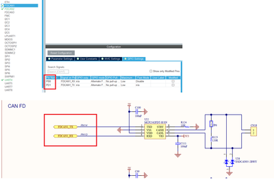

After checking your .ioc file, you're configuring the wrong GPIO pins for FDCAN1 (PB8 & PD1):
According to the board schematics, you need to set:
PH13 for FDCAN1_Tx and PH14 FDCAN1_Rx.

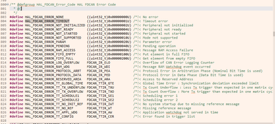

If there is an error, you can check it in the error callback.
void HAL_FDCAN_ErrorCallback(FDCAN_HandleTypeDef *hfdcan)
	uint32_t error;
	error = HAL_FDCAN_GetError(hfdcan);
If a reply has proven helpful, click on Accept as Solution so that it'll show at top of the post.
CAN Jammer an open source CAN bus hacking tool
CANableV3 Open Source
Thank you for the advice! I implemented your code and was able to see the error code: 512 (HAL_FDCAN_ERROR_FIFO_FULL). Any idea what could be the cause of it? How do I solve it?
Could you please share your .ioc file?

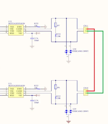

How did you connect FDCAN1 to FDCAN2?
Yes, of course! You can find the .ioc file here. As for the connection between the buses, I followed the following schematic:
For my main.c file, please check my original post.
Thanks for sharing these materials.
One more question: did you fit JP6 and JP7 in order to connect termination resistors of 120 ohm?
Yes, I do have the termination resistors connected.
mƎALLEm
@Nick_Tesla please confirm if it was an issue of pin configuration.
